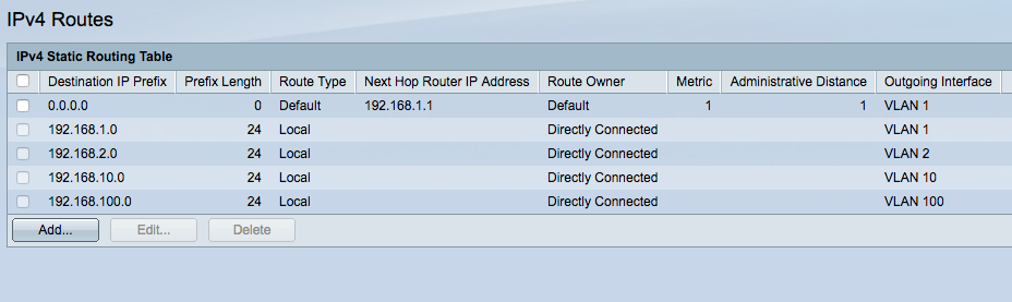

Richard Thanks again.
IPv4 Routes for the three switches---(appear to not have next hop listed)
Switch: 192.168.1.4
Screen Shot 2018-09-04 at 5.42.26 PM.pngSwitch: 192.168.1.2
Screen Shot 2018-09-04 at 5.43.32 PM.pngSwitch 192.168.1.3
YES -- They are all the same. I am guessing that I need to fix the next Hop router. Does this need to be the neighboring Switch or something else. In other words  my linear setup is GW (192.168.1.1)--> SW (192.168.1.4)-->SW (192.168.1.2)--> SW 192.168.1.3). Should x.1.3 next hop therefore be x.1.2, and should x.1.2 be x.1.4, and finally x.1.4 be x.1.1 For VLAN 1 and for VLAN 2 be  x.2.3 and x.2.3 ...?
Do I need to fix the destination IP?

This additional information is helpful. As far as the IPv4 Routes page not having next hop for the Local Direct Connect routes is concerned this is the expected behavior. Having those routes in the table is what enables inter vlan routing. And for a route that is Local and Directly Connected there is no need for a next hop since the switch can simply ARP for the destination address and there is no need for a next hop (which is only needed for remote destinations). I am glad to see that all switches have the 4 networks/subnets as Local and Directly Connected and that all switches have their default route as 192.168.1.1. This should enable inter vlan routing and will send anything remote to the router.
