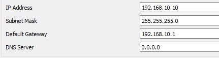

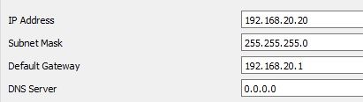

This is my last attempt on routing on a STICK!
WIZARD1325
WHAT IS WRONG?????????????
ROUTER
interface FastEthernet0/0
no ip address
duplex auto
speed auto
interface FastEthernet0/0.1
encapsulation dot1Q 10
ip address 192.168.10.1 255.255.255.0
interface FastEthernet0/0.2
encapsulation dot1Q 20
ip address 192.168.20.1 255.255.255.0
SWITCH
interface GigabitEthernet1/0/1
switchport access vlan 10
interface GigabitEthernet1/0/2
switchport access vlan 20
interface GigabitEthernet1/0/24
switchport trunk encapsulation dot1q
switchport mode trunk
setup.jpgnothing pings
anywhere
