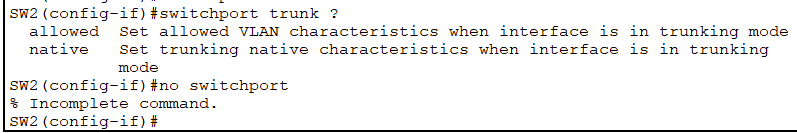

Trying to configure PAgP with IPv6 but there is no needed command.
gastrit
I need configure PAgP and IPv6 on L3 switches, but I Can`t do this.Screenshot_1.png

There is no such command as switchport trunk encapsulation dot1qScreenshot_4.png
Change switch model on PACKET tracert or you can use other tools like: GNS3, EVE-NG, VIRL and so on :)
