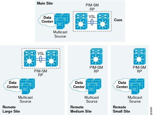

It is assumed that each medium enterprise site has a wide range of local multicast sources in the data center for distributed medium enterprise IT-managed media and employee research and development applications. In such a distributed multicast network design, Cisco recommends deploying PIM RP on each site for wired or wireless multicast receivers and sources to join and register at the closest RP. The Medium Enterprise Reference design recommends PIM-SM RP placement on a VSS-enabled and single resilient core system in the three-tier campus design, and on the collapsed core/distribution system in the two-tier campus design model. See Figure 2-43.
Figure 2-43 Distributed PIM-SM RP Placement
