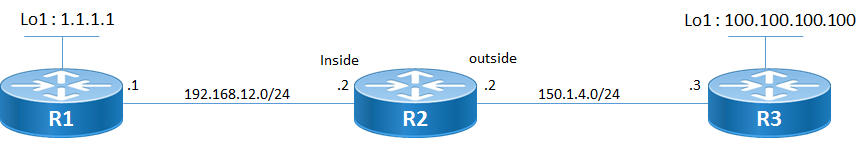

1.トポロジ
[[{"attributes":{},"fields":{}}]]
