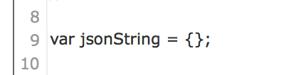

The purpose of this write up is to take the APIC Inspector JASON and create a UCSD task from it.
Step 1)
     Copy below script into a Cloupia task:
importPackage(java.io);
importPackage(java.util);
importPackage(com.cloupia.lib.util);
// REPLACE THE CURLY BRACES BELOW WITH A SINGLE LINE OF JSON RETRIEVED FROM APIC VIA
// THE API INSPECTOR. RESULTING CLOUPIA SCRIPT WILL BE WRITTEN BY DEFAULT TO THE
// FOLLOWING LOCATION ON UCS DIRECTOR: /tmp/apic_wf.js
var jsonString = {};

Step 2)
     Open up the task and fix up a few things...
     Obtain from the APIC Inspector the JASON String:
     You are looking for the payload
     Adjust for inputs for the new task:
          In this case I have a Tenant Name:
     Run workflow
This created a file on the UCSD appliance in /tmp:
The file should look some thing like this:

This section needs to change to my Tenant variable:
var NewTenant = input.NewTenant;
From:
     javaMap.get("fvTenant").get("attributes").put("dn","uni/tn-orfapitesttenant");
     javaMap.get("fvTenant").get("attributes").put("name","orfapitesttenant");
     javaMap.get("fvTenant").get("attributes").put("rn","tn-orfapitesttenant");
To:
     javaMap.get("fvTenant").get("attributes").put("dn","uni/tn-"+NewTenant+"");
     javaMap.get("fvTenant").get("attributes").put("name",""+NewTenant+"");
     javaMap.get("fvTenant").get("attributes").put("rn","tn-"+NewTenant+"");
Note: Fast way to change these
     cat apic_wf.js | sed s/orfapitesttenant/\"+NewTenant+\"/g
