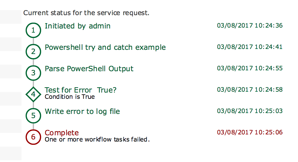

The workflow execution:

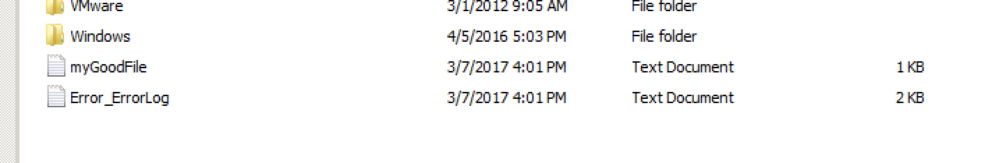

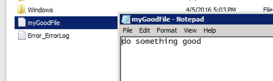

The resulting log files on the Windows server:

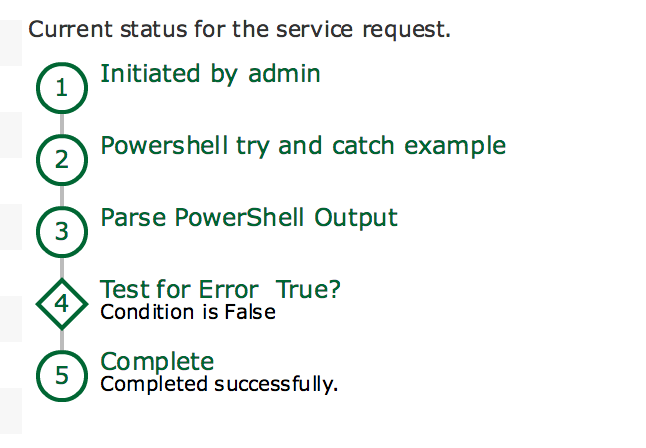

Workflow execution if there is no error:

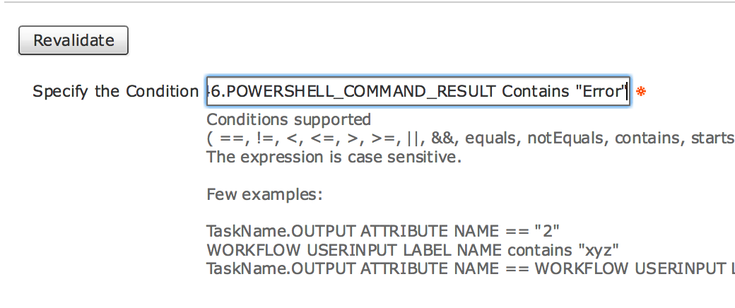

The If statement:
