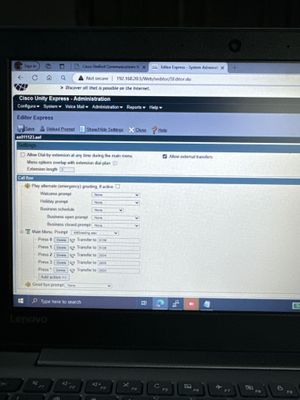

Hi all in regard to the Auto Attendant. I have my prompts setup. Now if a caller doesnt make a selection I would like it to Automatically transfer to an extension. Is there any way of doing that?
Thanks in advance.
@JDT69RR - You are looking for the parameter "disconnectAfterMenu" which should be set to False. Then the call is sent to the Operator Extension if no selection is made.
https://www.cisco.com/c/en/us/td/docs/voice_ip_comm/unity_exp/rel10_1/online_help/cue_gui/cue_gui_chapter_0100000.html#task_z2v_ls2_sjb
Maren
Hi @Maren Mahoney I’m in the GUI and I’m not seeing that option.
Use the "Goodbye Prompt" and select "Transfer to Extension". A little hunting around goes a long way.
Note that the Help > For this Page will help you navigate the options available in almost all of Cisco's products.
Maren
Hi Maren,
That is not an option under the Goodbye Prompt. It only allows me to choose from various prompts (.wav) I have been hunting through the GUI and still continue to come up with nothing, hence why I ended up here.
Drat. I'm working off of memory and the Admin Guide, as I haven't laid hands on a CUE in a few years. I know I've programmed this behavior, and I'll dig through my notes again to see if I can remember how.
There is a scripting tool for CUE that might be able to help. I don't know that Cisco makes it available anymore, but it may have come with your original software. I found when programming CUE that the scripting tool was super-helpful. Do you have access to that?
Maren
Unfortunately I do not have access to that. I attempted to look through the CLI to see if I could see the actual script or any of the configuration as well and nothing. Alls I’m trying to achieve is one menu. Press this for this and then if you don’t select an option you get transferred to the operator. I have set up a hunt group for the operator so that will ring appropriately once automatically transferred.
