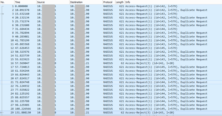

Below is a PCAP of my ASA with radius requests to ISE. Note the id=142, id=143, etc etc.
The ASA automatically starts creating NEW radius id's every ~15 seconds.
The access-rejects to the ASA only apply to a particular id. So the first access-reject at the 57 second mark is for id=142. At that point access-requests with the id of 142 stop. The other ones keep going (143, 144, 145).
Not 100% sure what causes the radius ID changes. It might have to do with the radius RFC.
Anyways, long story short, not much we can do. I have a couple of other ideas to try and will let you know how it goes.
