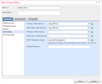

@Irakli Gvishiani can you provide screenshot of what you've configured please?
I Get this error

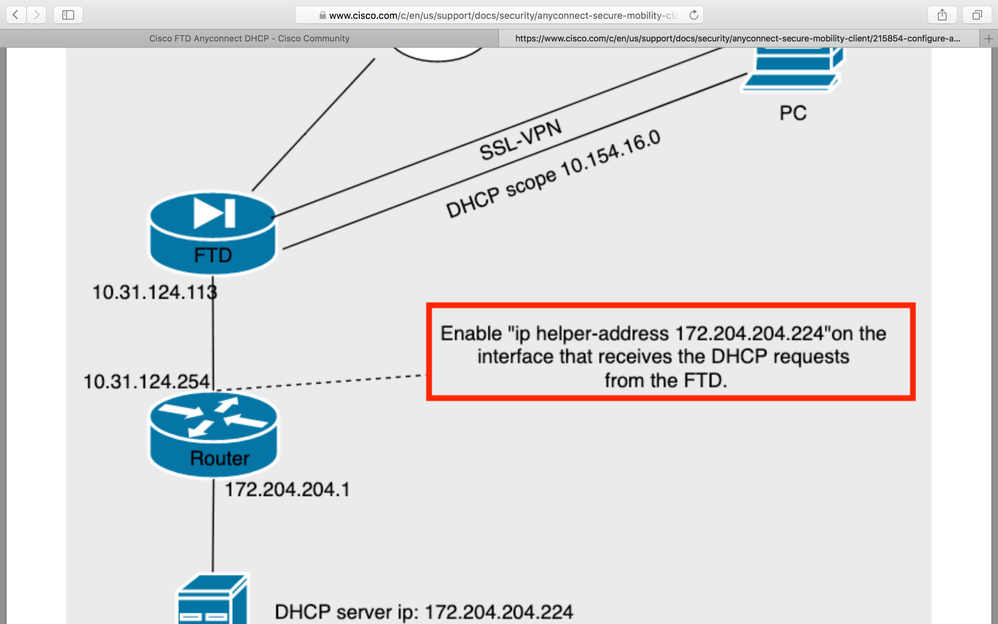

Also I have added DHCP Relay Configuration on my core switch as it showed in manuals.

Is the object "obj_DHCP_Scope101" from the same network that is configured on your DHCP server?

1 - Yes, obj_DHCP_Scope101 = 192.168.101.0 (Host), on the DHCP Server I created DHCP Pool 192.168.101.0/24

Also I run Wireshark on the DHCP server, but it doesn't receive any DHCP requests from FTD
I follow comment between you and Mr.Rob,
and finally you mention that the DHCP Server is connect to Core not directly to FTD so please config the IP helper in Core interface connect to FTD and check again.Screen Shot 2022-02-03 at 7.13.50 PM.png
