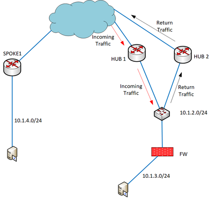

Please give me favor to ask about IPSec return traffic and WAF traffic.
  1. I have IPSec network and my branch site have two ipsec tunnel. Tunnel0 is primary  point to HUB1 and tunnel 1 is secondary tunnel point to HUB2. I played static route in firewall.if  i want to go traffic as below and i change static next hop ip is HUB2 in firewall,some my traffic cannot reachable to my branch.Let me know why ?

1. Why do you want to route traffic like that? It would be better to either use 1 hub active and the other for failover. Alternatively use a routing protocol and use both hubs in active/active.

1. You could use a static route, however if the first Hub failed the static route would remain in place and blackhole the traffic (unless you combine with IP SLA/Tracking). Hence why using a routing protocol would be bettter.
