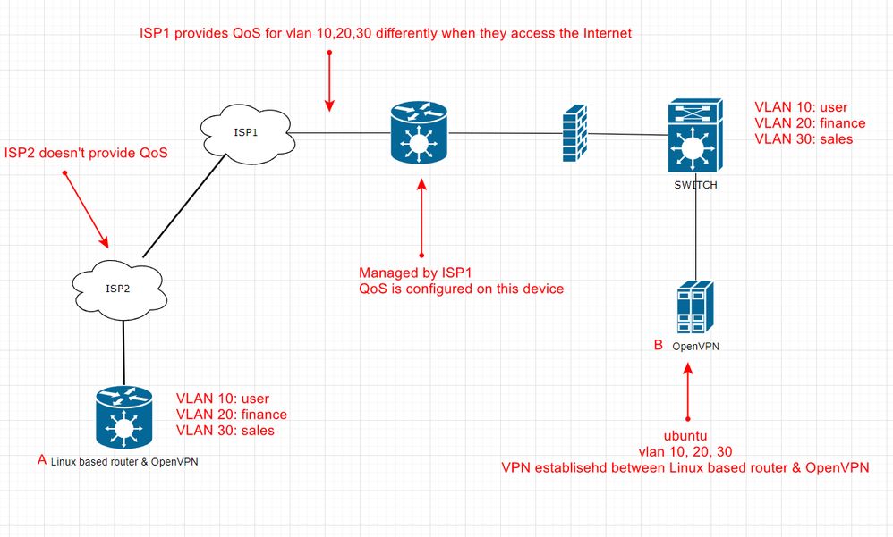

Hello there,
I have one question.  
Do you think QoS is working between A and B?
An OpenVPN session is created and established between A and B and QoS is configured on the Router managed by ISP1 only(No QoS IPS2 side).
So, when B generates traffic with tagging VLAN 10, 20, 30 over the VPN destined A, QoS is working correctly?'
My understanding is that since VPN is established between A and B, and when B sends traffic tagging vlan10,20,30, it will be encapsulated on B, and the Router managed by ISP1 cannot tell each Vlans, so just treats it as normal traffic.
Please correct me and give some more details about this.
Thank you.
QoS is end to end. If ISP one dont apply QoS then theres no QoS.
 Yourr understand is correct.
