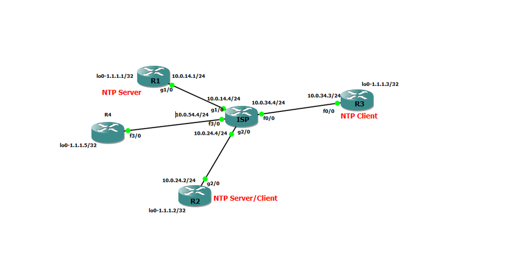

Now i tested as below diagram.
  • R1 = NTP master
  • R2 = client of R1 ( ntp server 1.10.1.1)
  • R3= client of R2
  • R4= peer to R2
After configuration without ACL ntp sync is work properly but R3 sync time is a little longer than R4 .
but after i put ACL rule in R2 . All ntp cannot synced.please see below pic

On high level i looked at the config, If you want to R3 need to query to R2, you need to Allow R3 IP address in ACL.
make sense ?
BB
Hi ,
i already allowed R3 traffic in R2.but still got error.
Post the errors, also enable debug for NTP see wht causing the issue ?
BB
