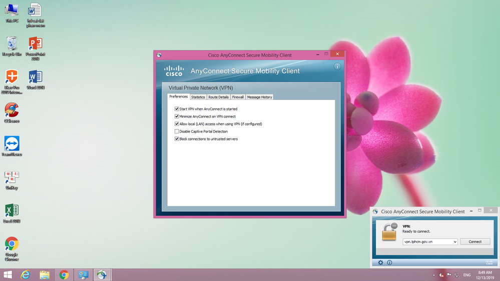

I am having the same issue using an Urban 4G MIFI router, Model 2.
I am able to access the internet.
