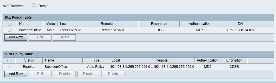

I am attaching a screenshot from the other location:
Considering the output of Show crypto Ipsec sa on the 2911 Router, It looks like you didnt configure the DH Group yet you configured Group 2 on the RV134W.

So for now I have removed the 10.10.3.0/24 subnet out of the equation, just to see if that makes a difference but it has not. See the screenshots from the Cisco RV134:
