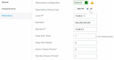

Hi @Leo Laohoo
Both controllers are in HA, this is their configuration:
I don't think there is one, but could you give me a brief explanation of what SMU, APSP and APDP mean and what function they have?
