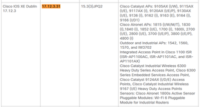

I would like to confirm if this Access Point Image Version Number 17.12.3.31 is compatible with 17.9.4a cupertino
Device ID: AP505C.88D5.872C Platform: cisco C9120AXI-A, Capabilities: Router Trans-Bridge Interface: GigabitEthernet1/0/38, Port ID (outgoing port): GigabitEthernet0 Holdtime : 169 sec
Version : Cisco AP Software, ap1g7-k9w8 Version: 17.12.3.31 Technical Support:
Copyright © 2014-2015 by Cisco Systems, Inc.
I was checking compatibility matrix and this image version is for Cisco IOS XE Dublin 17.12.3, but Im not sure if there is forward and backward compatibility of versions, I mean this ap will be able to connect to WLC running 17.9.4a? if is compatible, I'm having issues connecting this ap to the WLC.

 - Normally this should work (downgrading the AP) ; if you are having issues with this, then describe them in the initial post too; it will become more productive and possibly you will get a faster solution (...awaiting...)
