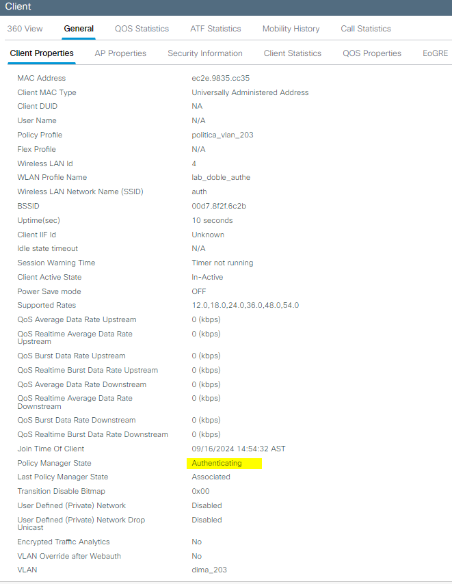

I have an SSID with 802.11x, version 17.9.5. I get "cannot connect to this network", the status remains in "authenticating" from other devices it joins correctly with the same credentials, I attach the logs

as per your trace, it seems like credential failure, make sure the account is not locked, password is correct and device is not placed in exclusion list because of multiple failed try.
%DOT1X-5-FAIL: R0/0: wncd: Authentication failed for client (ec2e.9835.cc35) with reason (Cred Fail)
