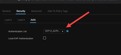

So I have decided to break it up for troubleshooting and will start with the wlan and AP settings for the network. I have configured the WLAN to have the following
and the radius server
. I have tried with the following setting unchecked and checked in the Policy that the Policy tag maps the wlan profile too because in the white paper I did see this setting needed to be checked.
I have researched this issue on Microsoft and some have given some examples but they still do not work. So to start, I would just like to make sure my WLC configurations are correct? Any guidance or input is greatly appreciated. Thanks
