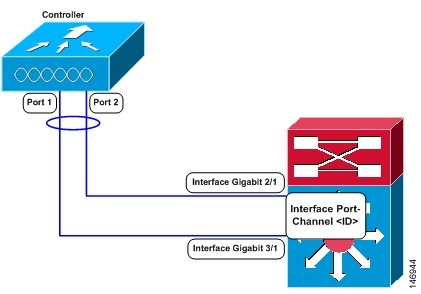

At a max you can do is terminating them on two different modules within a single Catalyst 6500 switch provides redundancy and ensures that connectivity between the switch and the controller is maintained when one module fails.
https://www.cisco.com/en/US/i/100001-200000/140001-150000/146001-147000/146944.jpg
You cannot configure the controller's ports into separate LAG groups. Only one LAG group is supported per controller. Therefore, you can connect a controller in LAG mode to only one neighbor device.
