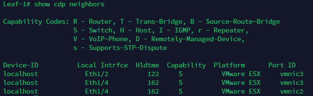

One did not, but I suspect that maybe the NIC of the one that didn`t come up is defective since it doesn`t even show in the cdp neighbors of leaf2 but shows duplicated in the cdp neighbors of leaf 1. Also someone who did this lab in the past here said that one of the NICs were acting strangely.
