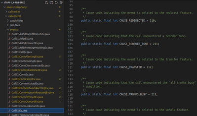

Good catch, as 214 seems to be CAUSE_UNHOLD:
This info is part of the JTAPI API spec, now owned by Oracle.  The Cisco JTAPI JavaDocs that are part of the SDK cover only the Cisco extension packages - perhaps unhelpful, but I assume due to licensing/copyright.
You can find this kind of info on Oracle's JTAPI spec page: https://www.oracle.com/java/technologies/jtapi.html
Click through and select the 'Specification / API' download link.  This has the uncompiled Java class interface files:
(Came across this, could be interesting: https://github.com/carloca68/jtapi
dstaudt_2-1691099810437.png)
Note this is for JTAPI 1.4, whereas Cisco JTAPI is based on the 1.2 version (for which I couldn't find a download) - at least for this kind of item, it should be the same.
