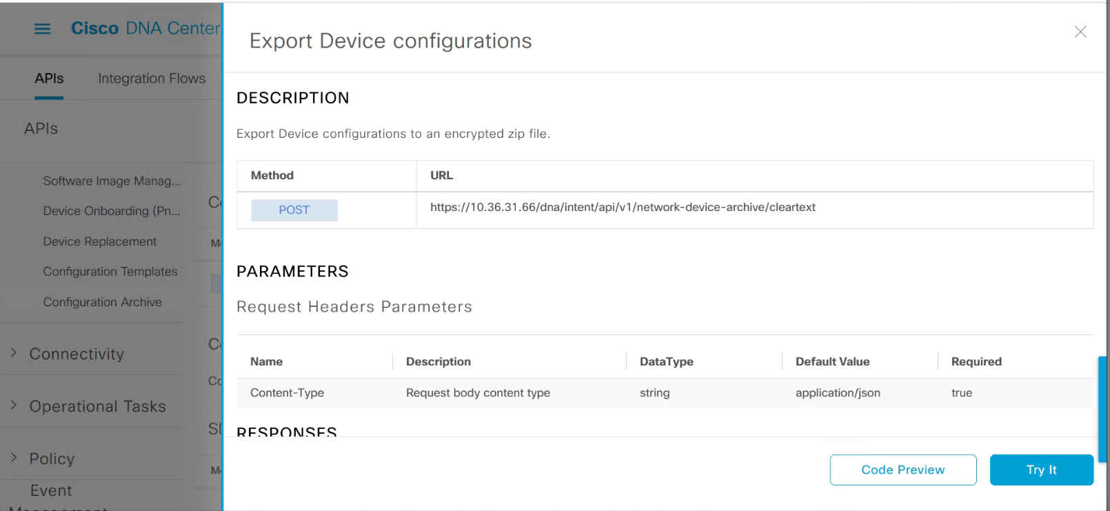

I'm runing cisco DNA center  Version 2.2.3.5 with 30 devices , I need to Backup configuartion using DNAC .
I'm Following the Guide attached but I'm strugling about the exact code to put on The API to get configuartion Backup .

Please reply on which step that you are having issues with and the screenshots of your test.
By the way, this is being added to the UI of the Cisco DNA Center in 2.3.3.x which will make it a lot easier going forward.
Configure External Server for Archiving Device Configuration
https://www.cisco.com/c/en/us/td/docs/cloud-systems-management/network-automation-and-management/dna-center/2-3-3/admin_guide/b_cisco_dna_center_admin_guide_2_3_3/b_cisco_dna_center_admin_guide_2_3_3_chapter_010.html#Cisco_Task_in_List_GUI.dita_130b3...
Hi Tomas ,
I have DNA Center version 2.2.3.5 , I did follow the steps monitor on doc you give but I didn't found  Configuration Archive in Settings .
I did use the API to archive config but I don't know how to use it .
