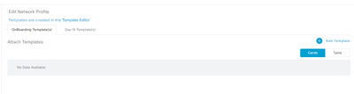

I'm fairly new to DNA Centre and struggling to understand the difference between Onboarding Templates and Day-N Templates when creating a network profile.
I've read the documentation but it's still not clear to me. Could someone please let me know the difference, ideally with a use case example. My network mainly comprises of Switches that I'm hoping to automate Plug-n-Play deployment and ongoing configuration for consistency and compliance. I'm not running any SDA at the moment.
Thanks in advance
