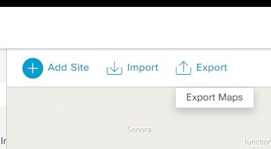

I don't believe that's an option for me. I'm running the latest DNA Center version, 2.1.2.6, and that option is not available. It is possible to export from PRIME and then import into DNA Center, but not DNA Center to DNA Center.

This is a screen capture from 2.1.2.6. There is only the option to Export Maps.

I have just tested the export feature on 2.1.2.6 and if you export you can import a "prime" map, and add the sites and blueprints from the exported file.ā€ƒ

Just tested with 2.2.2.1. Import Sites is now an option and it works just fine.
