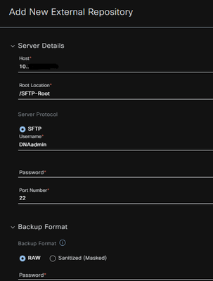

This is not working for me.  I am running Solarwinds SFTP server on a Windows 11 workstation with the root directory of C:\SFTP-Root.  I enter all of the information and continue to get the same error over and over.
Yet when I manually SFTP a file from a switch to the SFTP server, it works normally.
EDIT....I had to add a subdirectory to the SFTP root directory like C:\SFTP-Root\configs and then set the root to \configs in the configuration archive setup.  Working fine now.
