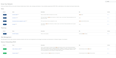

things stop to be pleasant... within my dnac 2.3.7.6 api i cannot find neither branch /controller nor site-scope node...
Well thats a pain. See if you can do this with /dna/intent/api/v1/network/{siteId} then export the hierarchy visualised in the Site Scope selection of the Application Policy, try and use the following API endpoint: GET /dna/intent/api/v1/network/{siteId}/site-topology
Hope this helps.
Please mark this as helpful or solution accepted to help others
Connect with me https://bigevilbeard.github.io
more & more interesting: there is no GET for this branch:
You are correct, there is no GET method for /dna/intent/api/v1/network/{siteId}. The API endpoint only supports PUT and POST methods, I just double checked the swagger file. I guess this leaves only?

not sure i got your Q... basically we need some textual(json,csv etc) representation of entire Site tree to have an idea to which of its nodes/branches App Policy has been applied & to which it wasnt.
i feel it will be faster to expand entire Site tree (yes, there is no control to make it & u need click each & every triangle in hierarchy to display its subordinaries) & then manually update previously prepared excel sheet with topology...
