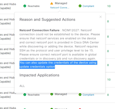

Hi Friends,
In my inventory list in DNAC, I have three switches with error Netconf connection failure in manageability column. I checked and did all the things that DNAC suggested. But I still have this error. In addition , I have below log in CLI:
66495: 066422: Mar 27 08:20:37.484: Switch 1 R0/0: ncsshd_bp: NETCONF/SSH: fatal: mm_answer_sign: Xkey_sign failed: error in libcrypto
DNA Software version is 2.2.3.4 and switch IOS-XE version is 17.3.3
I searched and found a bug related to this error.
 the screenshots of error.
Do you have any idea to solve this problem?
thank you in advance for reply
