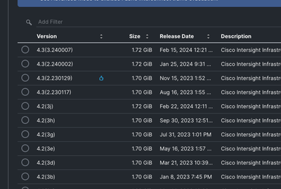

Brian, I'm having the same issue with Intersight in Saas mode.  Has anything changed in the past month where the blue "thumbs up" would not show up?  I do not see it for FIs, Chassis, or Servers.
Hi Daniel,
If you haven't tried it maybe a different browser or incognito mode?  This is from my SaaS account a few minutes ago:
If it still doesn't appear I'd recommend submitting feedback in the Intersight help bar.
*edit* - Also try expanding your "Version" column it looks a bit collapsed compared to mine and if so it'll hide
Brian, you nailed it.  The column wasn't large enough.  I'll submit feedback as a visual indicator of some kind to show that there's additional data would be helpful.
