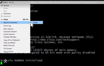

Actually, by pressing break on the terminal keyboard within 1 minute of power up in order to the router into ROMmon, alternatively try with spam ESC on your keyboard Just after you've started the device.
You can also try PuTTy for this...opening by Serial (with the correct COM port) and right click on the head of the window. There will be a pop-up window and you will see a point called Special commands. There will be your Break command. Once you restart the equipment you just click on it and should be arriving in the Rommon1> prompt.
