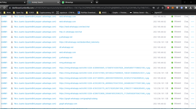

Hi All,
I'm trying to test Web Policy on Cisco Umbrella to block upload on Whatsapp, Wetransfer, and Dropbox. It turns out we can block upload only wetransfer and dropbox, there's something strange on Whatsapp.
If i test using Whatsapp apps on Windows it can block all upload files, but when i try using Whatsapp Web it doesn't block at all.
i don't understand why it happen. Can you guys help about this?

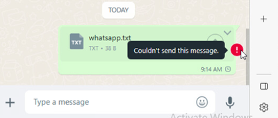

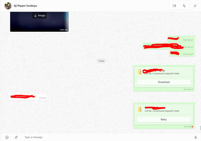

I understand that you are trying to block uploads on WhatsApp web, but it's been allowed instead.

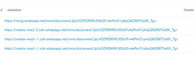

From your screenshots, I can see that is showing Allowed on the Activity Search report but on Whatsapp I can see the red icon, "Retry" and the time is different as well (10:44 vs 11:03AM). My question is, is that file being uploaded using Whatsapp web successfully?

Hi @aaragonb ,
Thank you for your reply and yes i'm trying to block upload whatsapp on Apps and Web.
Yes it doen't block on Whataspp Web but it blocks on Whatsapp Apps.
Belows are my setup on the web policy.
1. Block Upload on Rule

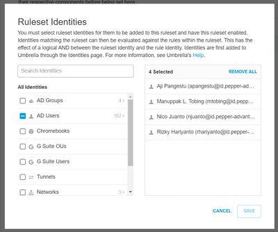

2. Make sure that my name on ruleset identities (njuanto@id.pepper-advantage.com)

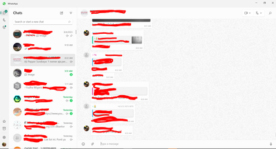

3. Able to access Whatsapp Web and Whatsapp Apps
4. Test Upload on Web.
5. Test upload on Apps
6. Activity Log Search
idk why on apps it is blocking but it doesn't show on log, instead of web.
i have raise a ticket as well to umbrella support but hasn't response. need to solve this ASAP.

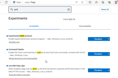

Do you have QUIC enabled? I would like to test the upload with QUIC disabled. To disable QUIC, browse "chrome://flags" and search "quic" and disable it from all:

Hi @aaragonb ,
I just tested the QUIC disabled on Edge since i never using Edge and it's work all whatsapp upload can be blocked. Why do i need to disabled the QUIC, because it neither enabled nor disabled, it only show default.
since i have 150 endpoint, i cannot disabled the QUIC on Edge and Chrome manually. Do you have any idea to do it automatically from Cisco Umbrella? or Does this app control has some bug?
We also tested using one of our networks as ruleset identites and it's work without QUIC disable.
In a nutshell, QUIC operates over UDP, which is not intercepted by the Roaming Client, it won't be proxied by Umbrella, so Umbrella won't be able to enforce the policies to that traffic.
As a workaround, you could block QUIC on your firewall.
Please, keep in mind, that in devices with the AnyConnect/Secure Client with browsers with QUIC enabled/default, it might happen the traffic won't be intercepted by the roaming module, because this one proxies TCP 443/80 only.
