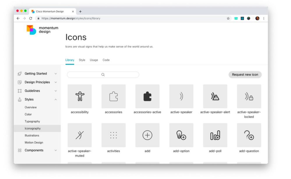

What about the icon you may wonder.. yes, and this is pretty cool. The device will look for a favicon on the web site its trying to open and set this as the button icon, and yes, you may choose your own icon by setting a specific URL to an image that will become the icon image.

Style guide
As a third party developer you do of course have the tools and freedom to design the web content exactly as you like or to match your company's visual profile.
If you prefer something that feels native and in line with the Cisco design language, you can find everything you need at https://momentum.design/.
As well as styles and guide lines, this web site contains CSS, assets, fonts and icons and component support for popular web frameworks.
