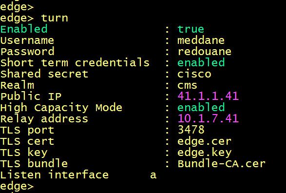

On CMS Edge:
turn short_term_credentials_mode enable
turn short_term_credentials cisco cms
turn public-ip 41.1.1.41
turn listen a
turn tls 3478
turn certs edge.key edge.crt Bundle-CA.crt
turn enable

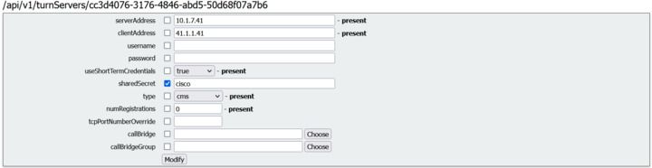

On CallBridge:

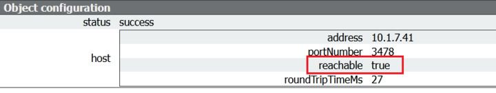

The configuration seems correct and it's straight forward, but the connection status shown that that the Call Bridge cannot connect to the turn server as shown below with the message Reachable = False,

Once the timezone is configured the status will be Reachable = True.
