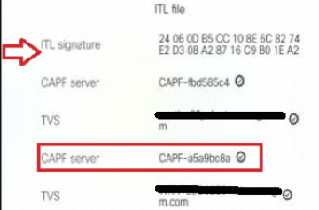

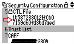

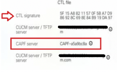

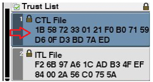

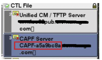

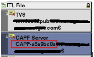

  3. Make note of current CTL/ITL content (on the phone > Settings > Security > Trust List) – see sample below:
Phone Type
CTL Signature
ITL Signature
CTL is signed by both USB e-tokens and contains CallManager and TFTP certificates – shown below by red arrow.
CAPF Server id – signed by usb eToken is shown in the red box below.
ITL is signed TVS certificate that is derived from CallManager certificate on the same node with TVS service – shown below by red arrow.

CTL signatures are of different values when comparing between 78xx/88xx vs 79xx legacy phones.

a.      Phones will soft reset and “Trust List Updated” in phone status message
b.     Phones will register back to its original ccm node
c.      Phones that support ITL will have an update to its ITL signature. CTL signature stay the same.

9.     Verify new CTL is updated the phone – ”CAPF server id” will be changed from prior value.

3.     Verify new ITL updated on phones
a.      Phones that register to this node will soft reset and “Trust List Updated” in phone status message
