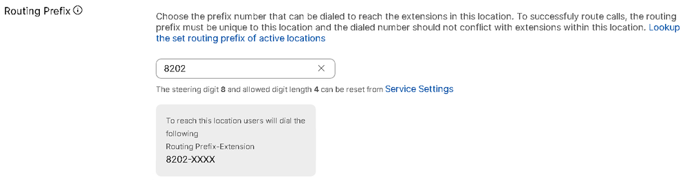

  • Location Routing Prefix Length: Similar to Site Code for on-premise intersite dialing.
  • Steering Digit in Routing Prefix: Similar to Access Code for on-premise inter-site dialing.
  • Internal Extension Length: on-net extension similar to internal extension (for example 4 digits dialing).
For on-premise solution : To dial between sites, we use: Access code + Site code + extension.
For Webex Calling cloud based-solution : inter-site on-net dialing habit is defined in the following form: Steering Digit + Location Routing Prefix + extension
Example : 8-496-9764
Note that the configured internal routing prefix length includes the leading routing prefix. To use three-digit site codes, the routing prefix length must be set to four.
If the routing prefix is set to “8” and the routing prefix length is set to four, always include the leading “8” in the routing prefix when defining location routing prefixes

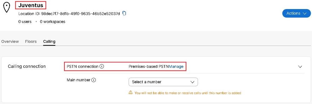

To route PSTN Calls we use Locations to provide PSTN access (Premises-Based PSTN or cloud connected PSTN).
PSTN Access Code is a single and a first digit that uniquely identifies the PSTN calls within the enterprise, The PSTN Access Code is typically useful and recommended in the Dial Plan Design to avoid overlaps with On-Net Calls. Digit 9 is an example of PSTN Access Code in US, and 0 in many European countries.
When an end user wants to call PSTN, he must dial the PSTN Access Code 9 followed by the PSTN +E.164 number. for example to dial international destination from US, the user must dial first dial 9 then the International Code 011 followed by the PSTN number.
With Webex Calling, on the Control Hub there is a Feature called PSTN Outbound Dial Digit available under each location. When using Cisco Webex Calling PBX Cloud-Based solution, to configure the PSTN Access Code, edit the Location and navigate to Calling > External Dialing > Outbound Dial Digit.

To route PSTN Calls we use Locations to provide PSTN access (Premises-Based PSTN or cloud connected PSTN). Webex Calling locations group together devices or users sharing the same geographical location (address) or sites. To do this we point the Location of the respective Site to the Local Gateway or CUBE (Trunk) if the site uses the Premises-Based PSTN (for example UK Site) or we link the Location to the Cloud Connected PSTN directly if the site (for example SJ Site) prefers to use a Cloud PSTN.
When migration from On-premise Call Control Cisco Unified CM to Webex Calling, you can facing a situation where some users are registered to Webex Calling while others in the same location are registered to the On-premise Cisco Unified CM. In this coexistence of both cloud/on-premises solutions, in order to keep user experience not impacted you want to preserve the intra-site dialing habits so that for example users can continu to use the dialing format 4 digits even if the site or the location is partially migrated to Webex Calling. There is a cool feature on Webex Calling Control Hub called "Route Unknown Extensions to the Premises as Internal Calls". To enable the option, edit the location the users belong to and navigate to "Internal Dialing" section.
When enabled, any calls from Webex Users in this location to unknown extension (same digit as internal extension) are routed as "Premises Calls" to the Trunk to the CUBE in this location or the Route Group that includes this trunk you associed to this option.
For example when a Webex User with extension 1001 dials the Directory Number of Jabber User 2001, the call signaling is sent to Webex Calling, since the dialed number 2001 is not a Webex Calling Extension (there is no user on Webex Calling provisioned with 2001) and no match in the Dial Plans. The option "Route Unknown Extensions to the Premises as Internal Calls" instructs Webex Calling to route any extension with 2-6 digits to the Trunk or Route Group associated to it. If disabled the call is blocked.
In the example below. To dial Extensions with 2-6 digits : 3001, 23001, 223001, there is no need of Dial Plan Pattern. To allow webex endpoints to dial jabber users extensions 3001, 23001 and 223001, we use the The option "Route Unknown Extensions to the Premises as Internal Calls" to route any extension with 2-6 digits to the Trunk or Route Group associated to HQ-RG that contains the Trunk to HQ-Trunk or to HQ-Trunk directly.
To dial unknown extensions with more than 6 digits, for example 2223001, we need a Dial Plan Pattern 222XXXX similar to Route Pattern on CUCM.
The "Verify Call Routing" Feature in Webex Calling Control Hub is similar to the DNA "Dialed Number Analyzer" on Cisco Unified CM On-prem control.
Like the DNA, the "Verify Call Routing" Feature on Control Hub allows you to test and to verify your call routing and your dial plan configuration. For example for calls between Webex Users in the same location or different locations, or for PSTN calls from Webex Users.
For PSTN calls to work you need to link your local gateway or your CUBE with the location if you are using on-prem PSTN provider, or you link the location to the Cloud Connected PSTN.
Locations are the central point of the Control Hub and Webex Calling Architecture.
It identifies the site the users belong to, and provides PSTN calls once the location is linked either to the Trunk to CUBE or to the Cloud Connected PSTN, in addition of others features like Call Permissions.
Once you link the location to CUBE or Cloud Connected PSTN, when Webex Calling receives a PSTN call from webex user in US-Location for example, it check first if the called number matches an extension's Webex User in different locations that exists on the Webex Calling, if no match is found, it check the Dial Plan (Similar to Route Pattern on CUCM) if there is a pattern that matches the called number, if no match is found, it uses the CUBE or the Cloud Connected PSTN linked to the location the calling user belongs to (US-Location in the example below).

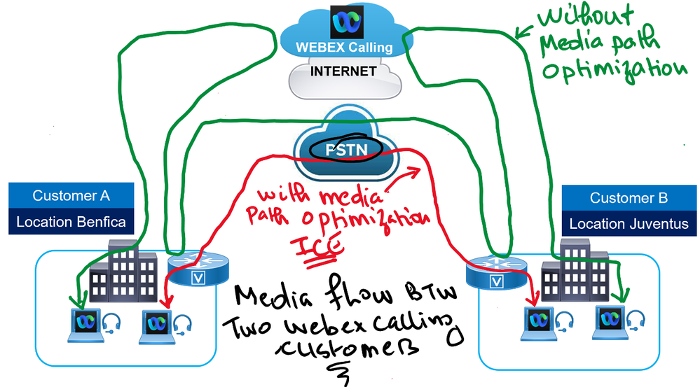

Media Flows for Calls between Different Webex Calling Customers
Calls between two Webex Calling Customers must be routed through PSTN because legal requirements, either with media path optimization between directly the PSTN gateways customers or without media path optimization going twice to webex calling then back to PSTN gateway.
