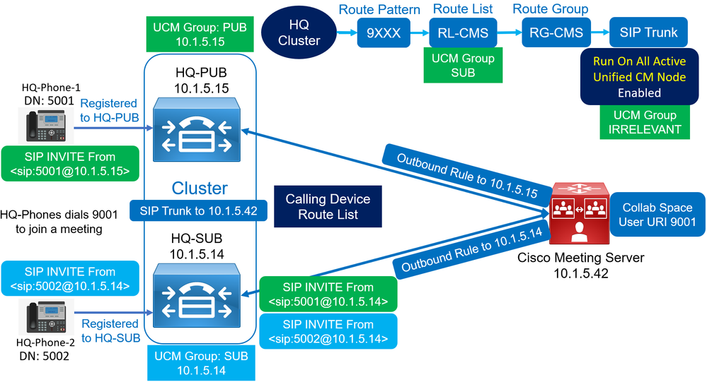

To first understand this option, first you need to understand that this option affects the outgoing call, more precisely when an endpoint let's say the HQ-Phone-1 registered to HQ-PUB dials the number of a space, and the call SIP INVITE is sent to the call control where the phone is registered to (affecting the "From" field and the Host Part of the URI in the SIP INVITE Header). The question that arises is : once the call is received by the Call Control, who is the initiator of the outgoing call in the Cluster CUCM with multiple Nodes running the Call Manager Services ?
The answer it depends, below you can see in some scenarios, the calling device is the Route List, NOT the endpoint, let me explain it :

3-Run on All Active Nodes disabled on Route List, enabled on SIP Trunk - In this case the Route List is the calling device.
Case 1 :
  • The Endpoint is registered to HQ-PUB 10.1.5.15.
  • The SIP Trunk with Run On All Active UCM Nodes enabled. Note : The UCM Group is irrelevant for the SIP Trunk.
  • The Route List is associated to UCM Group PUB that contains HQ-PUB 10.1.5.15.
For both HQ-Phone-1 and HQ-Phone-2 Calls. The outbound call is sent using the following From header: "5001" <sip:5001@10.1.5.15>, the Server 10.1.5.15 where the Route List is registered to is used to initiate outbound call.
Case 2 :
  • The Route List is associated to UCM Group SUB that contains HQ-SUB 10.1.5.14. Note : the Route List is the calling device.
For both HQ-Phone-1 and HQ-Phone-2 Calls. The outbound call is sent using the following From header: "5001" <sip:5001@10.1.5.14>, the Server 10.1.5.14 where the Route List is registered to is used to initiate outbound call.
As you can notice, The Route List is only active on one CUCM server, as a result all outbound calls will be initiated by the server where the Route List is registered to. This is not recommended.
