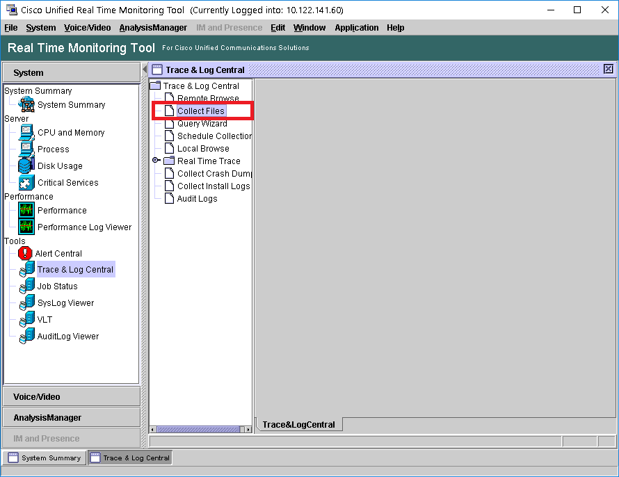

Step 1. Open RTMT and double click on Trace & Log Central
Step 2. Double click on Collect Files
