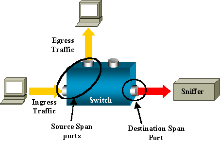

    A Switched Port Analyzer, referenced as a SPAN constitues a fundamental element to troubleshoot this type of problems. The SPAN allows to monitor the traffic in and out of a "Device" ( Router, Phone, CUCM Server, Gateway... ) to be copied to an external element for analysis. The host is not impacted during the monitoring since the traffic is copied by the infraestructure without the "Device" been affected. It's one of the less intrusive troubleshoting that can be performed. Setting up a SPAN certantly requires a physical setup.
    This link specified the configuration required on the Switch to enable the SPAN.
