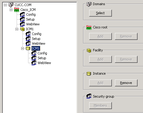

Now start the Cisco Unfied ICM installation by running the setup.exe. The first step to configure the domain manager before we can start the installation of ICM Router
Now click the Domain Manager
Domain is already selected in our case, so Add Cisco root
Add facility
And finally, add the instance. These setups are straightforward.
