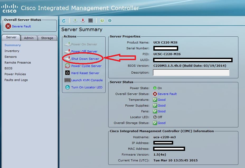

The below image is a screen capture of the CIMC and how to shut it down gracefully.
Always use the "Shut Down Server" for a graceful shutdown.  This ensures you arn't slamming ESXi.  Once this is complete, all VMs are officially off and so is the UCS C220, you can slide the server out and pull the cover off.  Remove all cables such as the power and ethernet At the back of the server is a screw that you have to loosen before you can press the thumb buttons and slide the cover off.  If you don't loosen that back middle screw you will not get the cover off and could end up damaging something, so please ensure you loose the screw!
