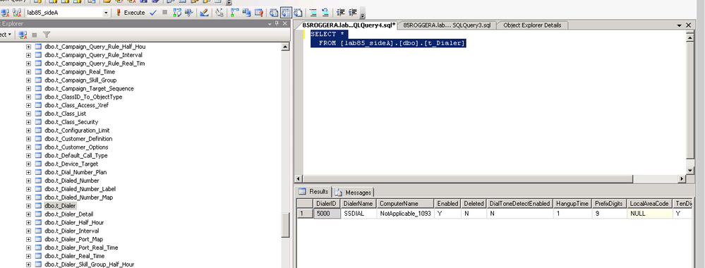

Can you connect to SQL yourself and run any type of query (i.e. remove UCCE from the picture completely)? This would at least rule out if SQL/the databases are having an issues vs. more of the UCCE/SQL integratrion having a problem.

I ran SQL query on Rogger, it works fine.

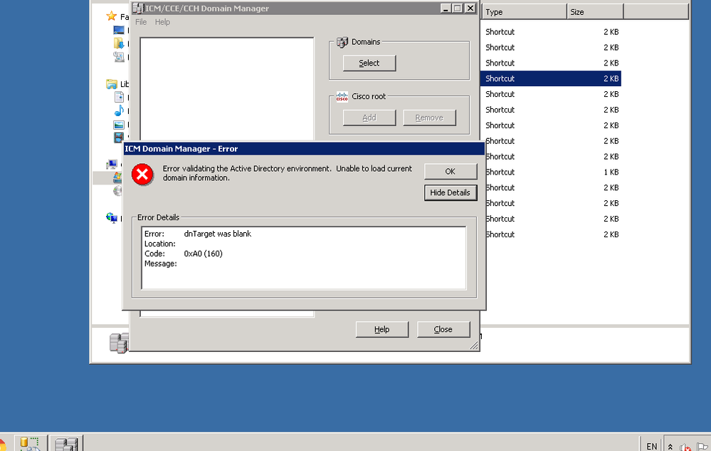

When I try to open Domain Manager there is error, is this something causing the issue?

So SQL is up, which is good. What is going on with your AD environment that Domain Manager isn't able to connect? Is the Cisco_ICM_Root OU still good? The server(s) that which the Rogger and AW are running on are joined to the domain? Is the Domain Controller(s) even online?

03-06-2018 11:00 PM - edited 03-06-2018 11:03 PM
Hey Chris and Bill,
Thanks a lot, we had issue with DNS and AD, restoring to a previous snapshot and then resting the computer account on all of the members to allow them to participate in the AD fixed the issue.
