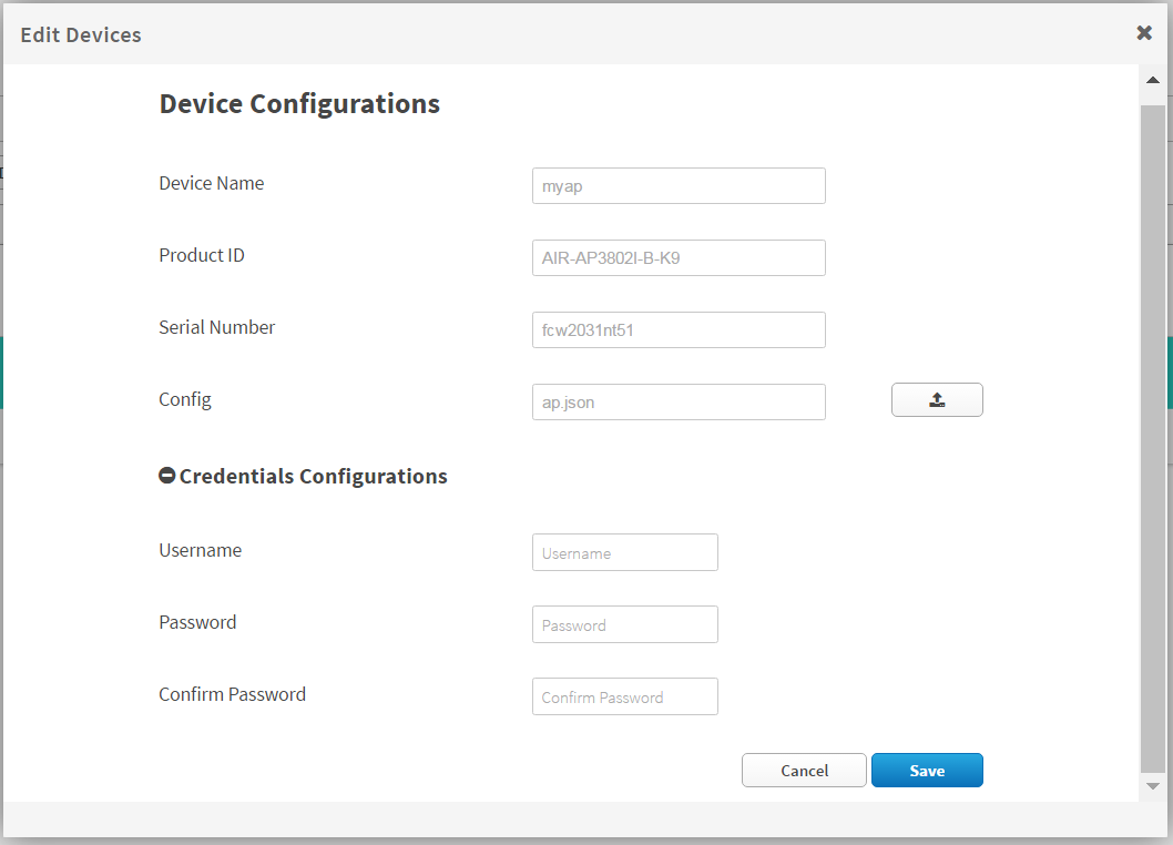

Good stuff, Nick. Thank you!  I'll make sure that I was reading the latest info but I did try to actually upgrade a 3800AP (which the doc I read said was not supported but 1.3 has it in the platform drop down) and if I built the project via the GUI there was no option to add an image to the device record.
Hi Claudia,
this is correct.  For AP, the config file (ap.json) contains the IP address of the WLAN controller.
The WLAN controller is responsible for upgrading software on the AP, not APIC-EM.
The other attributes are
  • wlc (primary, secondary, tertiary)
  • mode (local/flex)
  • apGroup
  • and flex connect group
Does that make sense?
