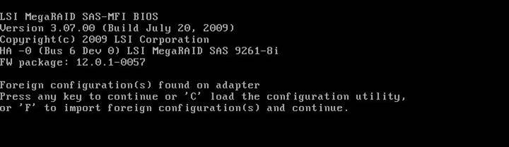

3-1:
After starting the server, you will see the following messages if Quiet Boot is disabled.
At that time, please press "F".
3-2:
If you press "F" after displaying the following messages, RAID configuration won't be imported.
But even if you press "F" at the correct time, you will see the same messages.
That is, we cannot decide at this step if RAID configuration has been imported correctly or not.
Anyway, please press any key except "C" for the next step.
