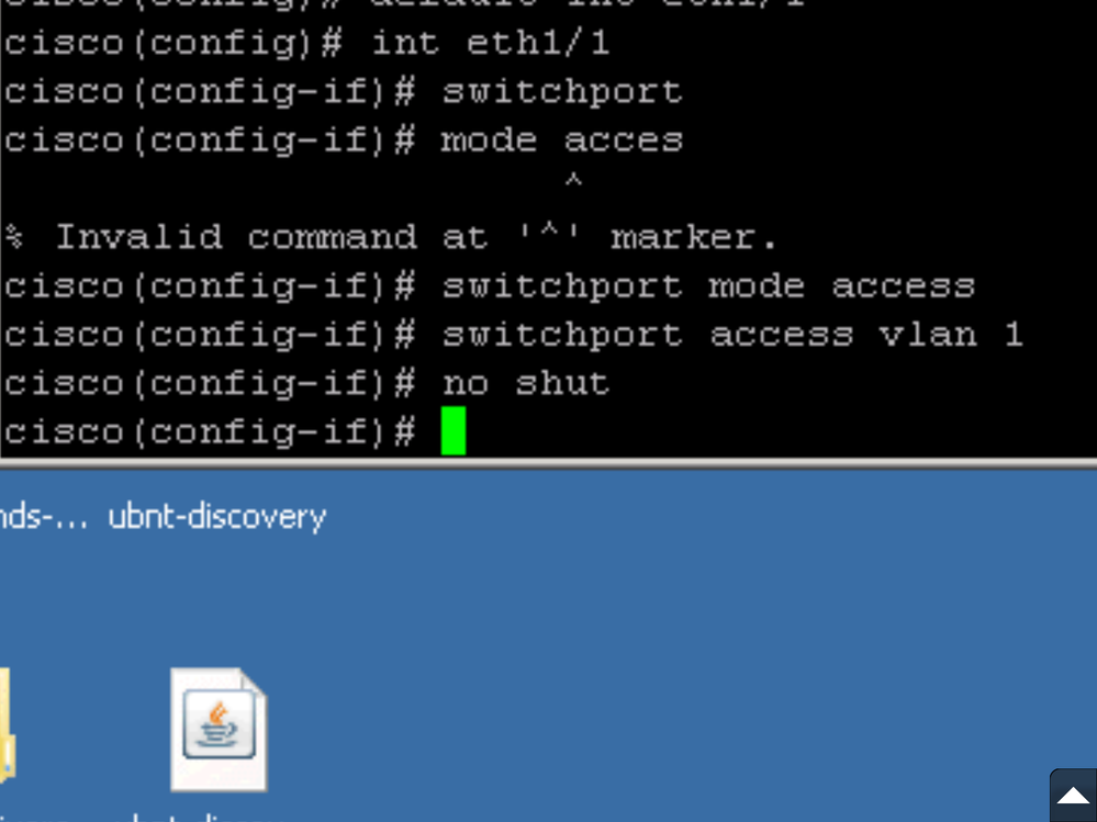

show run int eth1/1 as well did sh int eth1/1
Ok try something:
- shutdown this interface
- do a default int e1/1
And configure it again like this:
Int e1/1
switchport
Swit mode acess
Switc access vlan 1
no shut
Thanks
Francesco
PS: Please don't forget to rate and select as validated answer if this answered your question
F69D2B05-4274-4181-9500-85E5BECAC41C.png3B93AF0E-B7CF-4FBE-AB51-EBD81CD11FC2.pngEC4326F4-BFD6-4E24-8470-D8AB901571AA.png
Sorry photos are out of order, but performed the command, getting the error in the sh int br now. Which I thought was where I needed to change the speed
