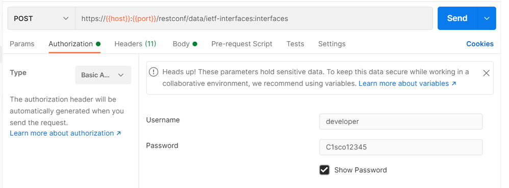

By the way, let me attach my RESTCONF request via postman for "ios-xe-mgmt.cisco.com".
Is there something wrong with the request information?
スクリーンショット 2021-05-13 092459.pngスクリーンショット 2021-05-13 092442.pngスクリーンショット 2021-05-13 092426.pngスクリーンショット 2021-05-13 092401.png

Thanks for the link!
It successfully worked on the latest version of CSR1000v, that is, 'ios-xe-mgmt-latest.cisco.com".
However, it is not working on the older version; "ios-xe-mgmt.cisco.com".
(using the same credentials, headers, body, etc)
I assume the older version is denying post requests.
