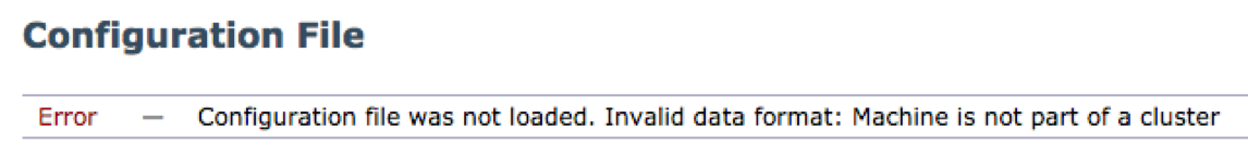

When loading a saved configuration, the appliance must be joined in a cluster.
If not - you’ll be presented with the following:

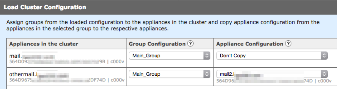

1) Load Configuration for Cluster:
For othermail.x, I want it to assume the appliance of mail2.x — so, I’ll set it as above.  (If I had other groups in cluster, I could also set that here — but, I only have the one group, as shown.)
Once review and commit completed - IP and hostname/listener is now set to be mail2.x.  Only thing I would need to do to complete mail2.x for completing the takeover of othermail.x would be to run sethostname.

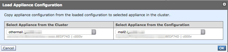

2) Load Configuration for Appliance in Cluster:
The column on the left is the appliances currently IN cluster, othermail.x  Select the appliance you intend to have the configuration loaded FOR.
The column on the right is the appliances that WERE IN cluster @ the time the configuration was saved from.  Select the appliance you intend to copy to the current appliance selected in the left column.  So, here, I want to assume the previous role of mail2.x

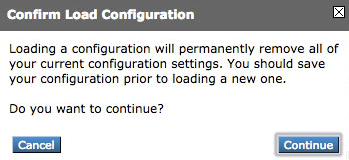

Once you click OK, presented:
Click Continue.
After - the appliance now has loaded the configuration for the appliance as indicated from the column on right, and now is named the appliance “mail2.x”  If the difference before was IP, hostname, etc - that is now loaded, and the appliance has assumed these previous configuration settings as per the configuration.
