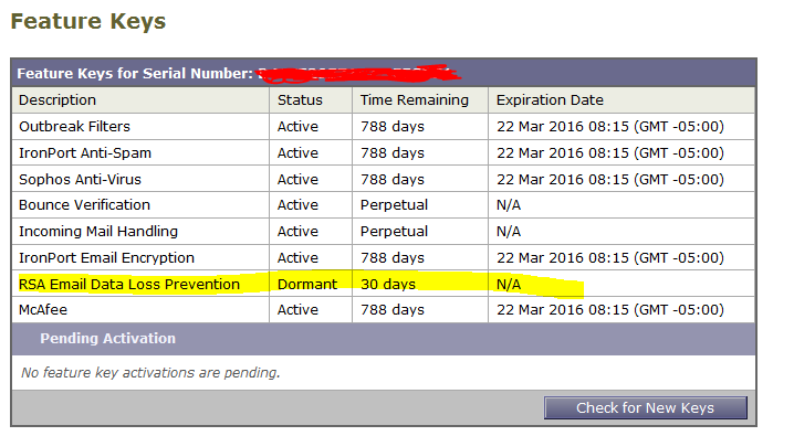

Hello Cisco Support Community,
I have an ironport C350 and i am using it as a test on dummy exchange servers before we implement it. I was configuring it's security settings and I came accross a problem where Mail Policies --> Ourgoing Mail Policies --> DLP ynder it, it says Not Available and when i click on not available it says "Not Found and that If you typed the URL directly, make sure that it is enetered correctly."
Can someone please help this is very critical. Also under Mail policies the DLP option doesnt show either
4 Accepted Solutions
Do you have a license for it?  Without a license, it will be unavailable.
Check System Adminstration/Feature Keys.
Click the Unavailable link and that should bring a new page on which you can enable it Globally. If you see there is no option to enable it, then you don't have the feature key, as Ken showed above.  You can ask for a trial. Engage the Sales Team.
You will need to work through your Sales Ops/Account team, or Reseller, in order to purchase the keys as needed.
