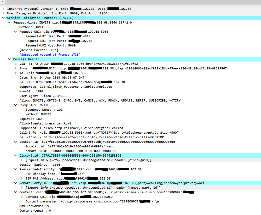

Hi there,
Thanks for responding, it's much appreciated.
Here is a shot of the packet capture of the INVITE that gets the Bad Request back:-
The INVITE is sent when I try to dial an external number.
Best, Leigh
