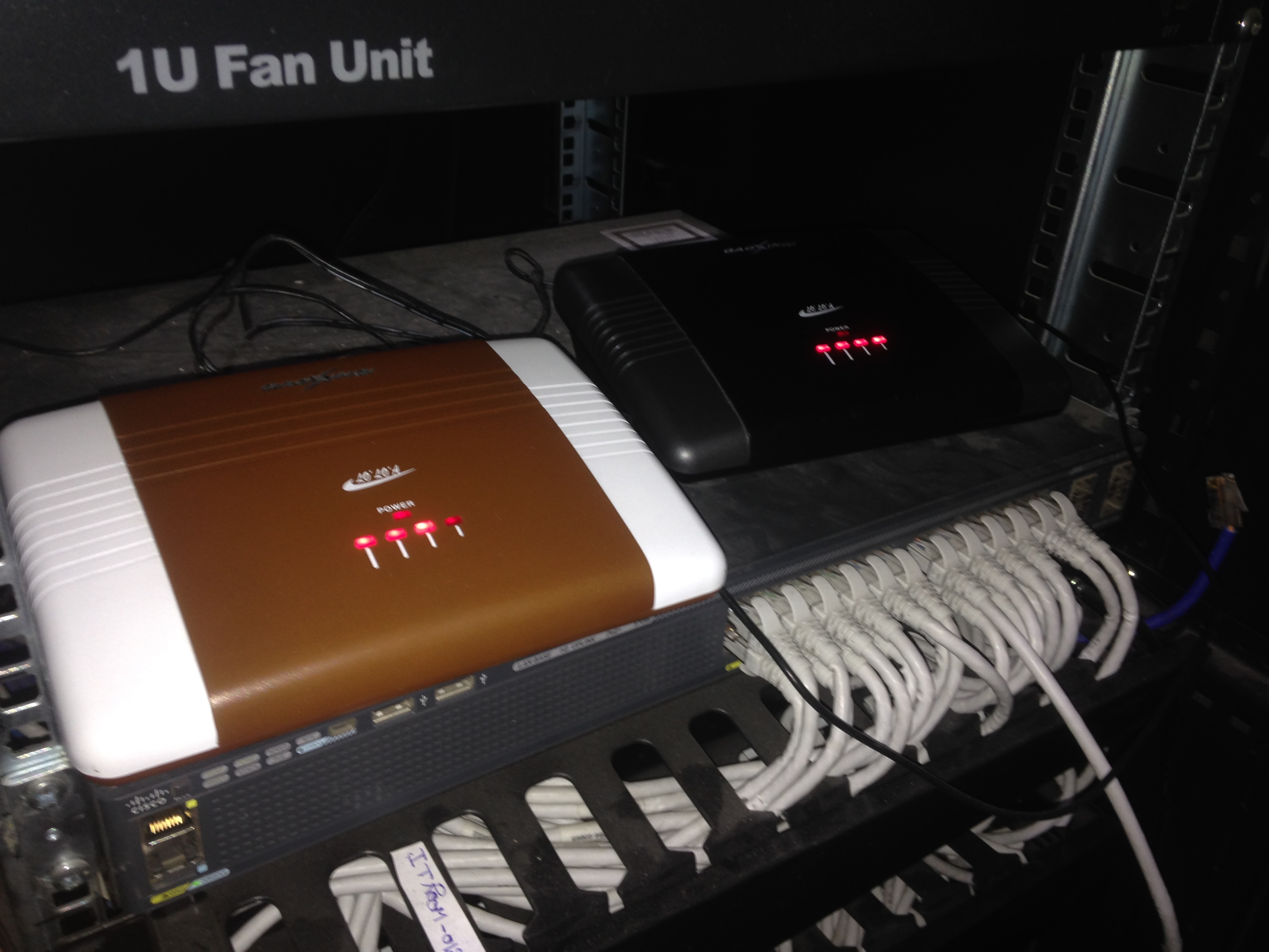

dear all
i have problem with my CLID (incoming call showing unknown number) why ?
i have 2 primacell with 2 vodafone sim cards directly connected to router 2911 FXO voice ports
i tried to call from my mobile to those two numbers of my company but showing as attached unknown number ? why not showing incoming numbers ? i checked with carrier vendor and tried analog phone with LCD screen its showing number normally but on cisco phone not
plz check attached config and pic of problem
