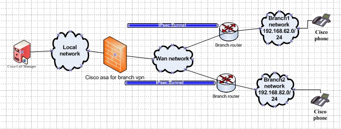

we using CM8.5. between extentions of head office and branch office is ok, but didn't hear voice (rtp port packet teardown udp connections) between branch office extentions through vpn tunnel. please see our topology and log, how to fix it?

Perhaps you need to enable inspection for voice protocols over the ASA. Also I think you might get more assistance moving this thread to the security community, we are not so familiarized with config on the ASA that could lead to UDP session teardown.
